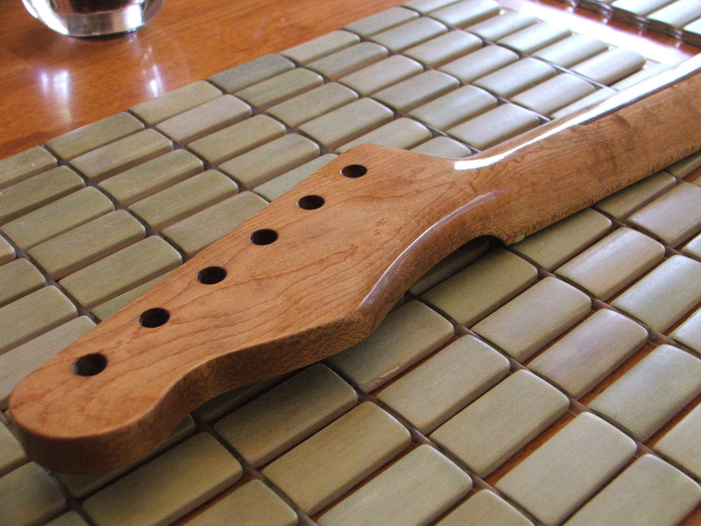

Yes, as a matter of fact I just buffed out a tru-oiled neck with a polishing wheel (sewn cotton) and Dico compound.  Ordinarily I would use white rouge (WR1)but couldn't find that tube so I used the one for plastics (PBC.)  I wet sanded with 600 grit paper and mineral spirits to an even matte then used the loaded wheel and it came out great.  You can get such wheels with an arbor designed for use with a hand drill.
I'll see if I can post a pic today.
Edit:  Here's that pic

Sorry for the pic size.
