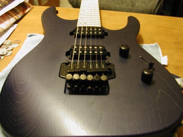

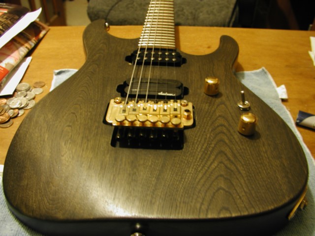

I think you were the one asking me about my Jackson's, are you talking about a finish like these? :icon_scratch:
lyon76 said:
yea that top one in the pictures
That's an ash body, no grain filler with blue stain...I'm not exactly sure what they used to cover the stain to protect it or if it even has anything on it to protect it at all...But it has a satin finish... :icon_biggrin:
