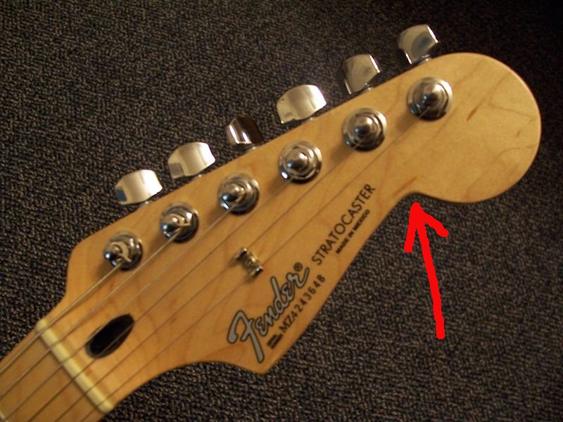

yes, the area near the nut I realize would be difficult to deal with, but practice makes perfect, and I certainly intend to practice a lot before the actual execution. (yikes! maybe I shouldn't use that word . . . execution . . .) I don't quite get the other part you say is difficult . . . maybe a picture would help to point it out?  :dontknow:
This is the point I'm talking about...
...although now that I look at it, it may not be so tight. Depends on the diameter of your router bit.
But, you're still going to have a helluva time back by the nut, unless you've got a CNC machine.
Doesn't seem anymore difficult than bound f holes. I have faith that it can be done. I say practice and go for it.
You don't have to route a compound curve to do f-holes like you'd have to with a Fender headstock.
Unless you have a 3 axis CNC machine that'll maintain its own reference independent of the workpiece but relative to it, you're down to carving tools. A standard router is only 2 axis, with the third depending on the workpiece and tool having a flat and maintained surface. Although, you could call a plunge router a 3 axis tool, but I don't know how you'd get the Z axis to follow a contour. Even then, if you look at the back of a Fender-style headstock toward the nut, you see that the vertical dimension isn't perpendicular to the top surface, so you need at least one more axis to compensate for that.
