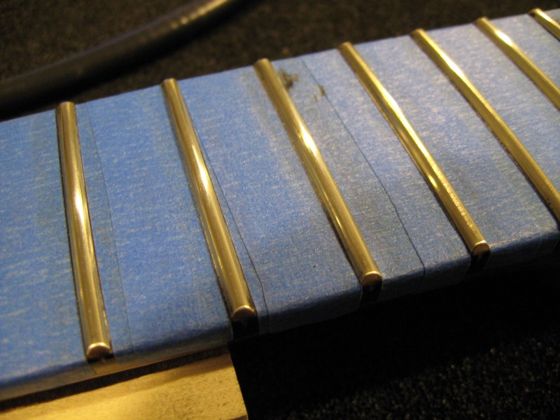

No, I ended up with guests and other distractions, so it went begging. I did get my fretwork done last night, so there's progress.
Need to order some rubbing compound to polish it up, but otherwise it should be good to go.

What do you charge for a fretjob, Cagey?
You mean I can charge for that kind of work? I'm going to have to re-evaluate my policies and practices <grin>
I like to do the whole dance with a neck, rather than the à la carte services many techs provide. That is, I want to straighten, level, crown, dress, and polish the thing, and sometimes replace the nut while I'm at it. I prefer to have the whole guitar so I can set up the bridge as well, but it's not really necessary. Anyway, $100 + shipping usually covers all that unless there are replacement parts involved.
