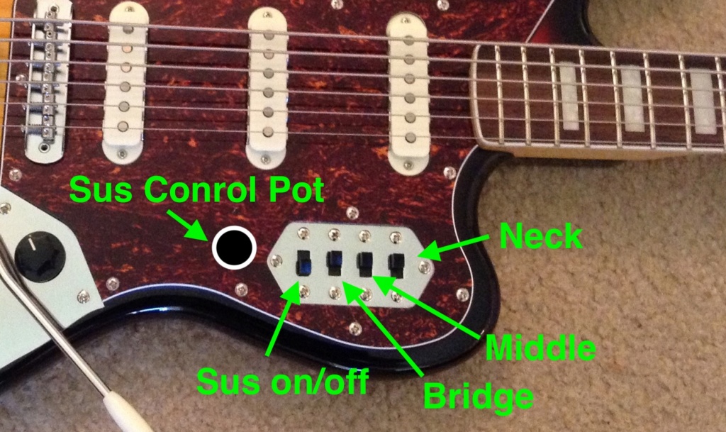

So here's the plan for the controls:
One of the switches to turn in on, and a pot to control the amount and type of Sustain, full Clockwise full root, full anticlockwise full octave sustain, middle is 'off'. Pull it out and it gives you 2 different sets of overtones.

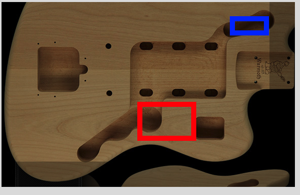

Here's where it will live:
red for the unit, blue for the battery, will need someone to get their chisel out for the control unit.
But this is everything I've got for it now:
:toothy11:
Hey - where did you get that 4 switch Jag lower switch plate? I can only find 3s, and need 4...
