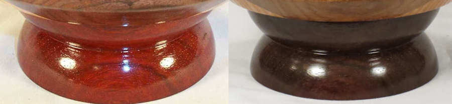

I know it'll fade, but I actually quite like that maroon brown it goes to
Other examples show a really dark brown with almost no red, which isn't as nice, but it's pefectly acceptable, and bloodwood is still harder than Indian rosewood, perfect for a fretless.
I've only done a few Bloodwoods, but I like to call it a "red Ebony". Very dense and hard. Heavy for a full neck, but you probably wouldn't notice it for a fretboard.

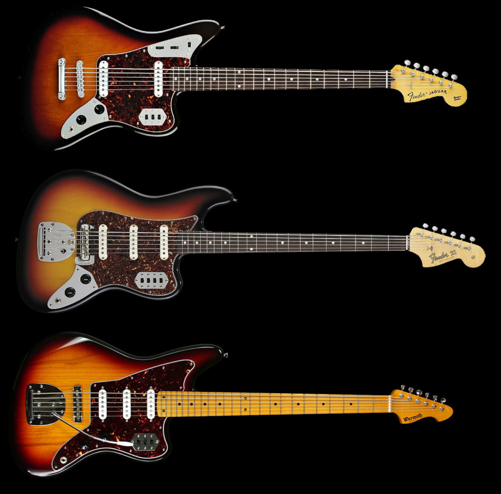

The Warmoth bass VI looks quite different to the Fender, more like a Jaguar with a Baritone/long neck.

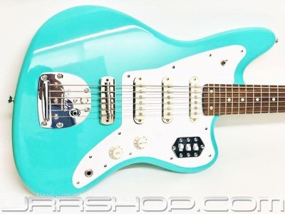

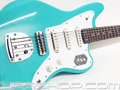

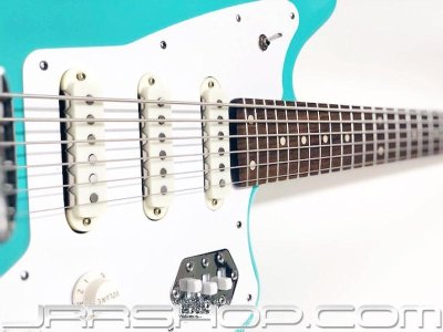

There also this eBay auction for a rather nice Warmoth VI,
https://www.ebay.co.uk/itm/Tone-Bakery-Warmoth-Bass-VI-with-Creamery-Pickups-New-JRR-Shop/202426899157
I'll attach the pictures just in case it gets sold and I need to see them again, and err. for your delectation.
So this raises a couple of points, should I go for strat style output jack and move the Sustainiac control, Volume, tone controls away from the pointy end?
Or a side connector?
Hmm, decisions, decisions!
I believe this what people call First World Problems.  :icon_thumright:

I like the strat-style jack, because I can sit on the couch and play guitar more comfortably, but I like the aesthetics of the side-jack better.  The non-strat style top-mount is more traditional, but I'd only use it with a 90 degree plug.  The idea of building a Fender VI keeps haunting me...please proceed with this build! (I know you're working on the XII build as well...I feel the same way about that one!  :icon_thumright:
That VI looks great ... but finish the XII!  I'm dying to see how that one turns out.
