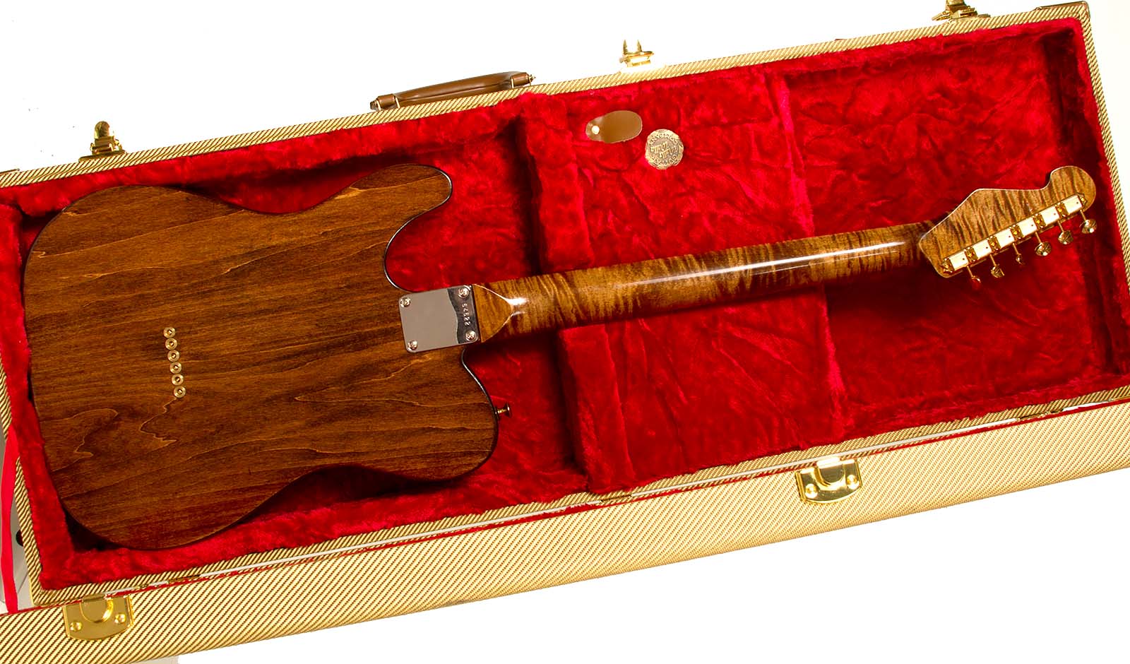

Thank you guys for the info, I had heard that Maple dosnt take to staining very well; I got intrigued when I saw the Walla Walla Guitar Company guitars, it looks like they stain blotchy or not on Maple, which is pretty rustic and appealing to me. https://wallawallaguitars.com/gallery-2/
This one of theirs sure speaks well of staining maple. It makes me think of trying it one of these days.

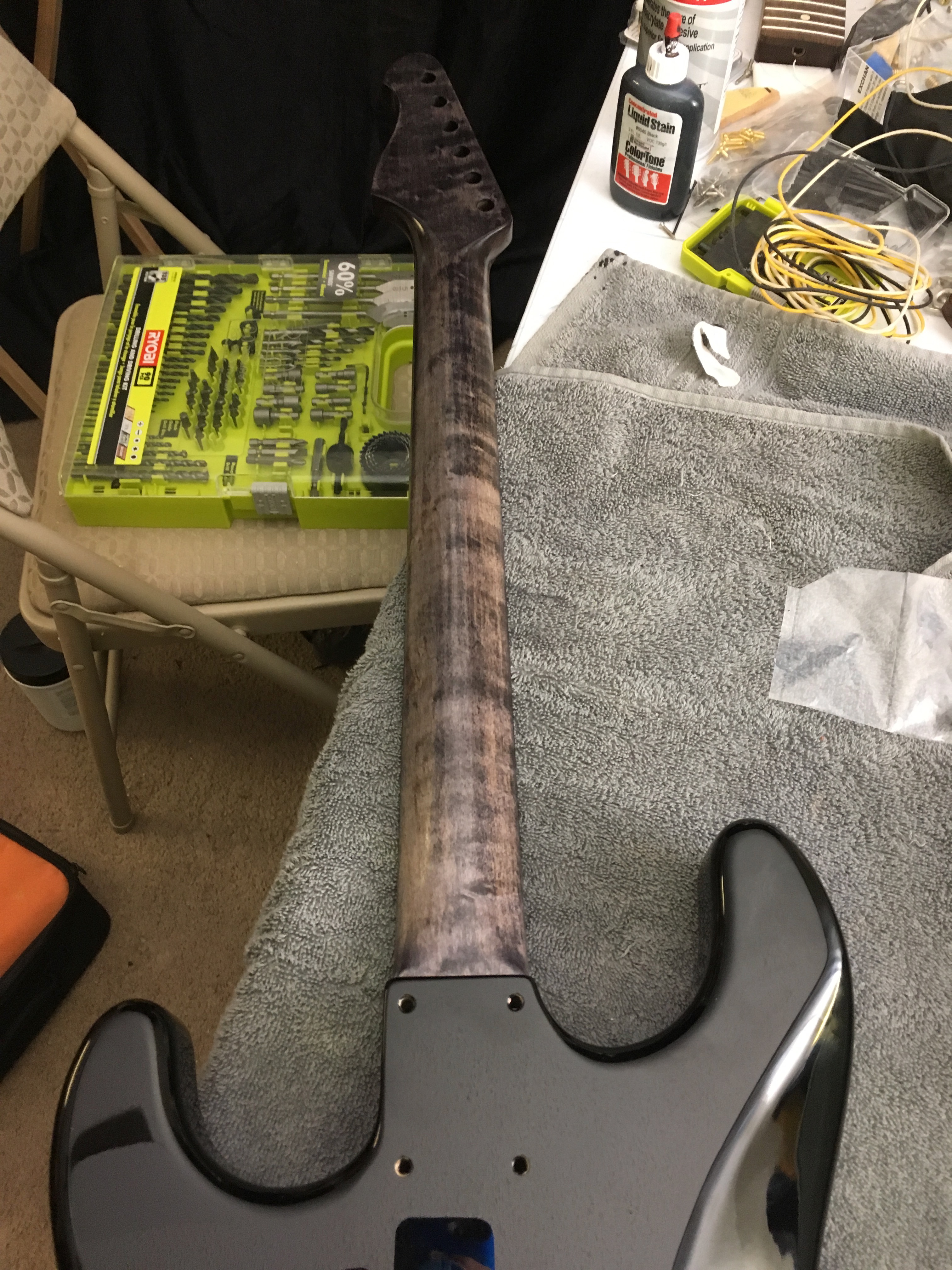

So I said heck with it and went with the direct on, I already knew that it would be blotchy due to the heavy burns from the Roasted process that were evident when I first saw and purchased this neck, which probably had alot to do with the $197 price tag, but Im a sucker for that old school thinking... that Roasted vintage modern construction must somehow get me closer to those old vintage tones.....blah blah blah
As expected it is blotchy but I do like the rustic look and hardcore effect, it also probably had alot to do with my sanding of the neck prior to staining; to better fit my grip, which now feels very meaty but comfortable, more of an SRV offset than a Boatneck which is what I originally wanted....more meat near the thumb a little less under the fingers,I put a slight roll on the fretboard and its very comfortable, feels awesome I cant wait to play on it.
I could have tried a prestain conditioner but I wasnt as concerned about uniformity as I was character.....but overall Im pretty happy with the results though if I did this in the future I might purchase a neck that didnt have the Roasted burns..... or maybe I would deliberately for effect, anyway things to consider on future builds.....
I feel I could have done a better job on the steel insert install if I would have had a 17/64" bit at the time; as drilling the insert holes out to 1/4" left too much thread diameter and the Roasted Maple likes to crack/split or sliver any chance it can being that its so dry, even waxing the wood and threads did little to help... and the Dry Roasted shavings will leave a couple of nasty slivers in your fingers if you get careless or anxious and wipe away the excess with your hands....
Still the inserts funtion great and it feels very obvious when you snug them just how much the neck and body really are one mass.

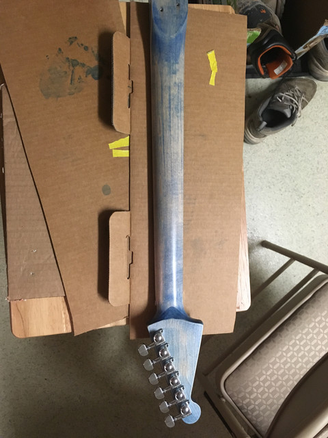

I did a black dye on a regular maple neck, it had a little bit of figure in it and came out pretty good. I put about 5 coats of satin nitro on top of the dye.
Also did a blue dye on a Floyd Rose Discovery neck, wanted a faded denim look.
It is tough to not get streaks in the dye with maple. Dilute it well and many coats.

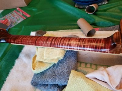

I used Keda Dye on a flame maple neck for this LP project I did a year ago. No problem at all.
