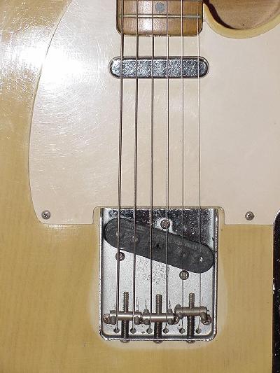

Thats a fake or a refin, or they would have showed it with the pickguard removed, and the teltale subtle identifiers fully exposed.

Ya I'd need verification from fender first.....I mean look how crisp the date is on the end of the neck.....alittle to crisp for something that's 55 yrs old... :dontknow:

Wouldn't the area under the control plate be lighter?
Shouldn't the whole thing be darker?

I think Tonar could get it that color with his blackguard finish maybe 2 hours in the sun. I doubt 50 years would keep it that light.

It's fake...with a couple of parts that might be vintage...
1.) Never saw a 50's Fender with any neck date in red - typically lead pencil - NEVER day penciled in, just month/year, or initials/month/year. Atypical to see dates that match that close.
2.) Were some parts kept in a hermetically sealed room, others not? Look at the bridge saddles/screws. If they're in that state, you should see similar aging/discoloring of bridge plate/tuners/other metal parts.
3.) Stamping including serial number in bridge plate is too "sharp" and serial number does not compute seem to compute for date....below is 1954 model

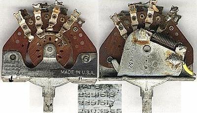

4.) You should see aging on bakelite parts of selector switch and switch tip; switch is wrong, tip looks wrong and wouldn't be shiny anymore.... Switch should look like this pic:
5.) A Tonar blonde repro finish after 2 weeks in the sun would be more convincing.
6.) Decal is correct, but none of them look like that after 55 years, freshly applied.
7.) Poodle case obviously re-issue
Note no pics with pickguard off or of pickups/bottom of pickups...
