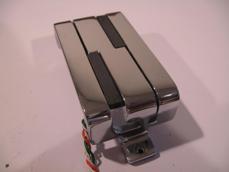

Last week I took delivery of a Lace Alumitone Pickup for an upcoming customer build and was quite surprised at what I saw when I unboxed it. These things are way off the beaten path. I know they've been out for a while, but they're new to me. So, I thought I'd share some some pictures with those who may be curious.

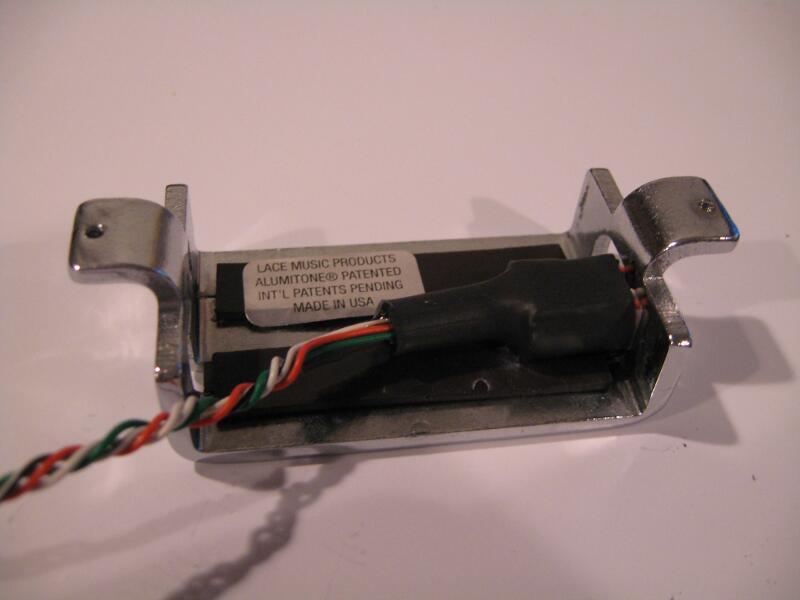

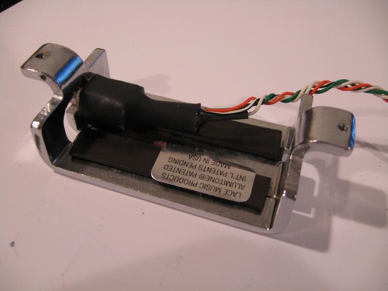

This particular unit is what they call "splittable", although there's obviously nothing to split. Clearly, there are no coils; it's a current pickup. So, they probably mean the current transformer is tapped. Brings out four wires, anyway. Interesting design. They're supposed to be ultra-clear and noiseless, so maybe they're a good candidate for the modelling or synth crowd. Stay tuned; we'll find out.

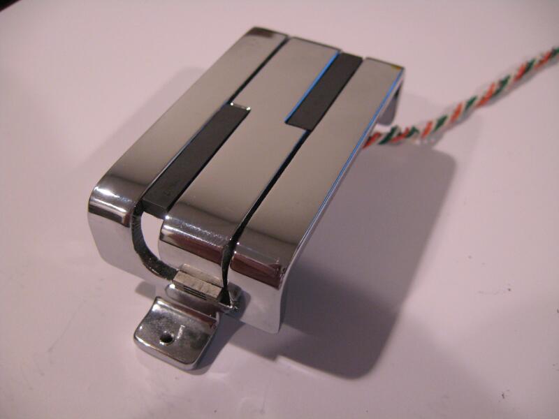

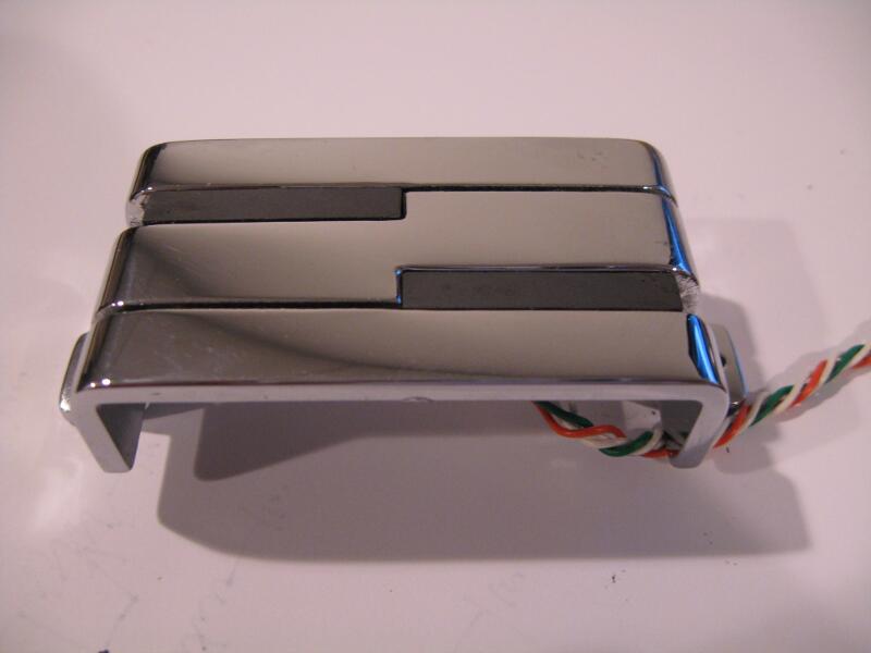

I'm a big fan of the appearance, too. The only downside would be if you had a guitar where the thing had to sit a little high in the saddle. They're not particularly attractive from the side. Plus, they're not quite as wide as a standard PAF-style humbucker, so you end up with about 1/8" more clearance on the sides of a standard mounting ring than you might expect. I think I may sheath the wiring in black so it's not so easy to see.

The difference in width, while noticeable to someone who's familiar with typical dimensions, is not that dramatic. If it were, the thing wouldn't pick up all six strings.

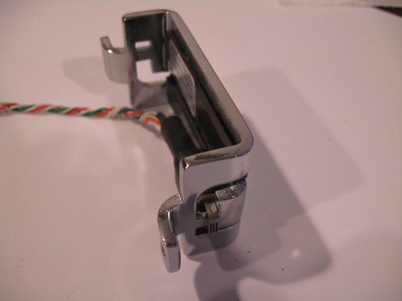

The mounting tangs are in the same place dimensionally as a typical PAF-style humbucker. Also, the mounting tangs reach down about the same distance. So, any mounting scheme you'd use for a PAF-style humbucker will work with these, including the use of mounting rings or direct mounts.
However, you'll notice that the frame is somewhat thick. So, rather than just force screws through it, you may have to do some drilling to get the the holes to a dimension you can use if you want to direct mount them. No worries, though. It's just aluminum, so if you have a pet gerbil/mouse/rat, it'll have no trouble helping you out with a bit of nibbling. It's pretty soft stuff as metals go. All the other metals made fun of or beat up aluminum in school.
One concern I have with this part is it seems the holes for the mounting screws were threaded differently than the screws they they provided, so I'm going to have to dig around for a tap to fix that. I intend to call them and bitch about it. Seems like an impossible problem to have, but this ain't my first rodeo. I know it's wrong. I stopped cross-threading screws 50 years ago.
