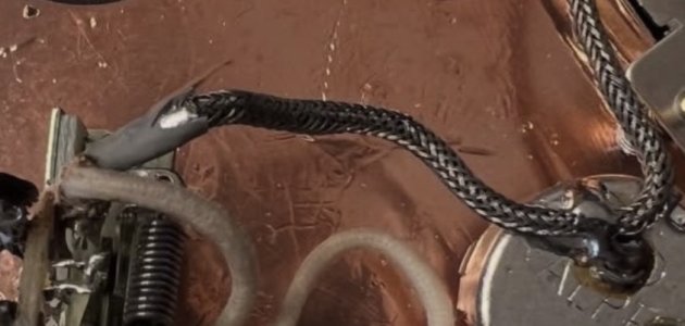

It looks possible to me that the braided pickup wires are grounding signal when all crammed into the route.
Crammed? The pickup wires are pretty rigid. I’ve moved them out to avoid obstructing connection points on the pots. The only contact between braid & neck tone pot is covered with heat shrink. But even still, typically a contact like that produces a loud ground hum. This circuit as it sits is virtually silent.

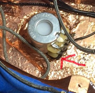

There’s clearly something grounding out the signal when the neck is engaged based on the symptoms - the shielding is fine to share as many grounding points as you desire. My guess is some solder is accidentally bridging your signal and ground either on the back of the pot or at the switch connection in this part:
If that’s true, I’m guessing either at the grounded tab, since it’s also sharing claw ground and jack ground, or same below the switch connection lug underneath towards the lug tabs? Plus my neck pickup is not picking up any k readings. Just the bridge.
Any contact locations to check with my multimeter? Something to isolate the chain of flow? Also, I appreciate you taking the time to even answer my post. I have this gut feeling it’s something obvious and I’m just stuck in my head. Lots going on in my life at the moment.

Check or ohm meter each pot leg to the copper shielding. The tangs for the pots are very close to its mounting surface. A slight bend would contact the copper foil, or there could be a small piece of foil from the hole cutout hanging around. I put a small piece of electrical,tape between the pot tangs and the copper shielding in my builds.
