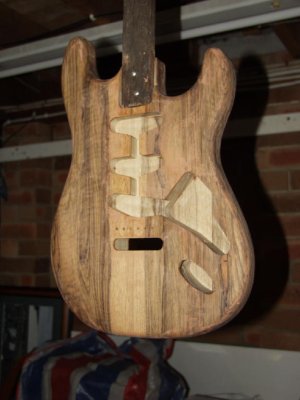

How to hold the body? attach a piece of wood to the neck pocket. Some people use the neck holes, others just screw the wood into the neck pocket.
