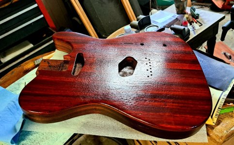

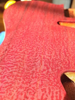

It's beautiful! Just gotta sand out the texture. 1000 plus sandpaper or even melamine sponge. gotta let it harden up first though. Then clear again over smooth.

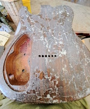

whoa!! What happened man?Heres nothing, sanding down and starting over View attachment 64990
I've had to do that before; not at all fun but definitely worth while to get the finish that you want! Good luck! You can do it!Heres nothing, sanding down and starting over View attachment 64990
