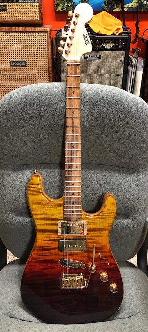

I kept my 3 pup build simple. A 3 way switch selects only one pup at a time. Each pup has its own volume and tone pot (concentric pots). It’s like 3 different guitars, a humbucker, a P90, and a single coil. Warmoth body and neck.
