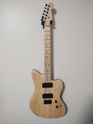

So I got a small router on Amazon and routed out pickup holes but not before routing my neck pocket because when installing the neck with the Hipshot bridge on the strings hit the frets even at the highest position so after all that everything worked fine. I have finished my project and all is well, I ordered a nut file yesterday for my low e string slot but have filed the test if them and it sounds great. I had to rewire it because the middle position on the 3 way didn't work but all good now. Only one problem, on the hardtail bridge the 2 e strings need to go lower and the mounting screws (one on each side and one in the middle) are in the way of these 2 saddles on one side so I can't go low enough because they hit the screws before they can go low enough and cause the saddles to tilt sideways. One side will go down but the other side hits the mounting screen on both high and low e, everything else is good. Any suggestions?

So there it is. I got the nut file in today that I needed for the low e string and completed that task. It sounds awesome. Still the problem with the bridge, I believe that I'll find some flat tapered screws, as the supplied screws have a dome top that sticks up and caused the problem and use them on the outside 2 screws, the middle screw poses no problem. I'll have to re-intonate it and all because I'll have to take maybe 4 of the saddles loose to do this job but no problem. I'm proud of it. I was going to go with white on the body but decided to go natural with the maple veneer looking pretty good. I used the 2K clear coat on top of the bullseye sanding sealer and after sanding the sealer to get it smooth like I wanted I believe I took to much off because it was darker and that really brought out the wood but it'll do. Fralin jazzmaster noiseless pickups with 5% overwind, 500k pots,.047 cap on the treble bleed (they recommended .022 but I tried it and like this one better) switch craft 3 way switch and simply wired like a Tele. Grover medium tuners, Hipshot hardtail bridge and LaBelle 11-50 flatwound (jazz flats) Warmoth neck with 1 7/8ths nut.
