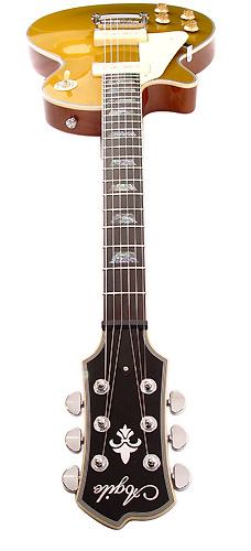

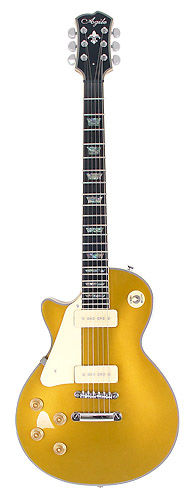

I would never buy anything from the SX line (unless I wanted a guitar to totally mod) - only the Agile line and even then, only 3000 models and up.
In fact...
http://www.rondomusic.com/al3010goldp90left.html
