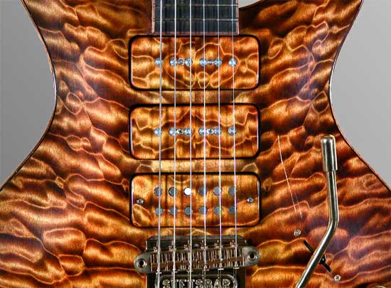

Does anybody has a clue how to do this:
I know it can be done with those very thin saws used to cut gold, pearls, etc... But I have no clue how to do the first step/hole, as I cannot see any in these guitars and bass with that kind of construction...
ByteFrenzy
Senior member
1,177
I'm not sure how they do it. I'm not 100% sure if the PU covers are the pieces removed from the top or different pieces that were selected to match. The seem to come very close but not perfectly... If it's the first, it seems likely to me that they use water or laser cutting to remove the PU covers from the lam top before it's fixed to the body proper. It would take some serious indexing to get the routing done afterwards though. The other possiblity is that they just have a huge pile of similarly figured maple to pick the best matching PU covers for each body from.
NonsenseTele
Senior member
8,256
I agree this one is not 100% matching, but there is plenty of bass from luthieres that matches... I'm really intrigued...

NonsenseTele said:
Awaking the Dead!  :evil4:
this is done by first drilling a very small hole (the diameter of the saw blade used in the second step) on the cut line. next the top is set onto a scroll saw with a very fine blade
and carefully cutting along the outline. since you need some clearance between the pickup cavity and the pickup cover, the thin kerfed blade is no problem if you cut skillfully
there are several ways to craft the pickup cover itself, and the piece cut above is simply glued onto the top similar to what is done with the body. it's not technically difficult to perform each of the steps - the difficulty is in having the tools/skills to work to a very tight tolerance when making the pickup covers since a little slop in the pole holes really stands out (you don't usually see the gap in the pickup cavity unless the original cut out was done very sloppy
