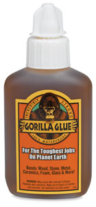

I use Gorilla Glue in screw hole , as it not going to crack and easy to screw in , as it not going to really harden.
