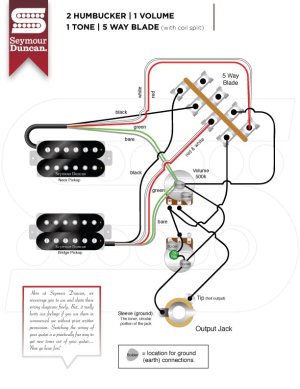

Aloha forum, I have an intriguingly simple Seymour Duncan wiring diagram for a two humbucker and 5-Way switch autosplit setup. But as with all SD diagrams, they provide no visual guide to what splits in each switch position. Hoping someone out there can interpret this diagram (attached). What is active as I switch through positions 1 to 5? I just cannot for the life of me figure it out.
As best as I can figure, it appears to be: 1. Bridge full humbucker; 2. Bridge and Neck full humbucker; 3. Neck full humbucker; 4. Bridge split and Neck full humbucker; 5. Bridge split and Neck split.
