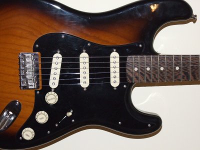

I have a maple neck with a wenge fingerboard. Love it.  I have no issues.  No gunk. It's a very smooth board.  Maybe a touch waxy feel, but nothing I am bothered by.  I waited around and picked a 'Unique Choice' board and it's stunning.  EVERYONE asks about it.
