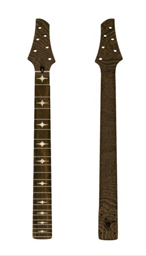

I'm working on a build and got it in my head to have a Ziricote fretboard, possibly on a Wenge neck. Having never played on either wood, I admit freely that this has everything to do with looks and Warmoth's description. Does anyone have any opinions or insight on either wood's feel, tone, weight, etc?

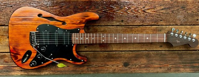

Wenge neck with Pau ferro board, stainless 6115's SRV roller nut mop dots 1757453199443.jpegWenge.jpg

Wenge and ziricote are about halfway between maple and rosewood in hardness and almost twice as hard as mahogany.
Wenge is about half again stronger for bending than maple and a bit more than that for mahogany.
Wenge should be more stable in general than your common neck and is known for it's very open grain that when polished/burnished tends to feel very smooth almost waxy. Bass companies make marketing claims about it's mid-range warmth in general - YMMV. Woodworkers hate it due to it's tendency to splinter at the slightest suggestion.
Ziricote has beautiful overlapping grains for nice pieces and is harder than a piece of unfinished maple while not quite as hard as rosewood. If that affects tone in your ears, apply accordingly.
For my eye, it may be a lot of competing brown on brown grain patterns, but would be a very nice thing to play.
