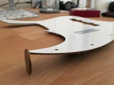

Received a new tortoise celluloid guard from Warmoth and the whole thing is warped like a cup, so the area around the pickup would bulge outward if you attempted to mount it. Warmoth support says "that's how the celluloid materials work". Anyone have a tip to safely flatten the guard? I'm a little afraid to put flammable material in the oven like I have seen suggested on the web. Other Warmoth builders must have run into this. Thanks.

Can you please post a picture showing how warped your pickguard is. When my strat pickguard arrived, it was dead flat.  ???
Hecka warped. Trying attachment, newb to forum so I will see if this works.

Well, 10 min in 200 deg oven then overnight pressed flat under slab of Corian and 2 gallon pot of water. This morning, looks roughly the same. If it was old and I owned it I would play further games but for a new purchase, it's going back. Got to decide if I try a do-over or just stick with the black, or no-guard.
This guard shipped in with a pack of Schaller strap-locks so it was in a box sort of loose. My previous black guard (non-celluloid) shipped in a flat Manila padded envelope. Maybe I'll try the do-over, it's a sweet looking tort even with the protective film still on.
