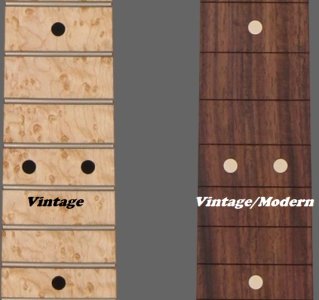

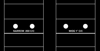

Well, the dot spacing you are inquiring about is as follows, wide being vintage and narrow being considered modern:

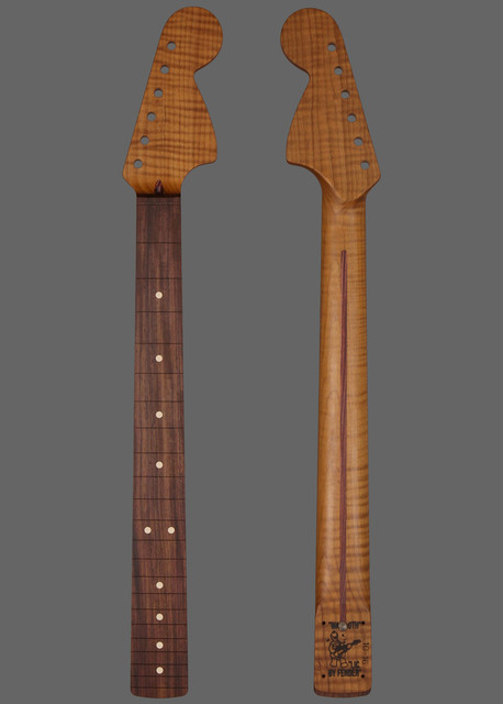

And here is an example of a Warmoth CBS neck that was freshly plucked from the showcase.
Yeah, but that's a vintage/modern in your image, not a vintage one.
