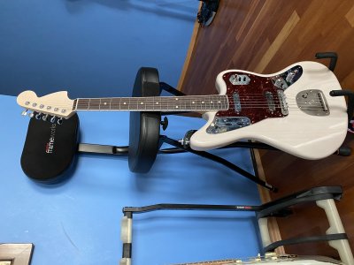

Stumbled upon this thread, I have one! :)
Antiquity 1s
SS 6150 frets
mastery bridge and vibrato
locking gotohs
3 way toggle switch/killswitch/highpass filter
standard rhythm circuit
500k bournes pots for lead; treble bleed; 0.047mF tone cap
quartersawn warmoth neck/ rosewood fretboard/ white binding
warmoth jag body; mary kay white
