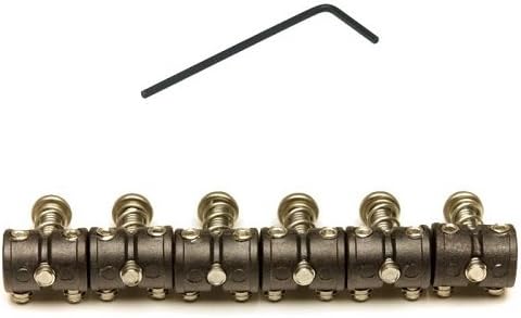

Right. Somebody did the math one time, and I believe it ended up being around 18.25" Actually, it matters little if you have an adjustable saddle height capable bridge. Fortunately, this has been addressed. Graphtech sells replacement saddles...
