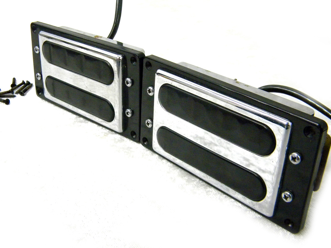

I’m slowly piecing together a project using a pair of humbuckers salvaged from my Peavey T-60 to be installed in a Strat body. In doing so, I’ve asked Warmoth two questions:
(1) Will W drill a pickguard WITHOUT pickup mounting screws? The T-60 pickup ears have four mounting holes vs. the typical two and they are not centered:
Also, the center-to-center spacing of the mounting screws is about 3.14”, which is slightly wider than the spec that W drills to (3.075” to 3.114”). W’s response was “yes, they would omit the pickup mounting holes (for a $15.00) upcharge”. My plan is to drill these holes myself. I do not want to use mounting rings.
(2) Since the pickups I have would seem to be best served by a Trembucker cutout (2.853” x 1.5”) my plan was to order an H/H pickguard with Trembucker-seized routs. However, W’s website does not allow this selection for the neck position, so I inquired to see if it was possible to request it. W responded (emphasis mine): “We have never done a Trembucker rout in the neck position for the simple fact that the poles will not be aligned with the strings at that point of the scale. If you are using an alternate pickup that does not fit any of our available routs you or a local guitar tech/Luthier will have to perform the accommodating routs for your pickups. I would also like to refer you to www.terrapinguitars.com. They can make you a high quality, totally custom pickguard from as little as a detailed drawing.” I’d rather not go the totally custom route (no pun) because I think it would be overkill and spendy for what I want to do.
Ultimately, my plan is to install this into a Strat body with either an H/H, H/S/H or Universal rout. With these pickups, pole alignment is not a concern but I am now wondering if the maximum distance of the mounting screws, (approximately 3.25”, outside-to-outisde) would interfere with the body’s pickup rout. I guess I’m asking to see if anyone has a body lying around that could that could verify this dimension.
I could have directed this question back to W but I wanted to bounce my thought process off the collective brain trust here to verify my thinking.
Thanks.
