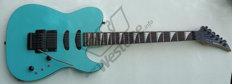

anyone seen/have a tele with a jackson neck? i'd love to see a pic of one before i wig out and just buy it.
m4rk0
Senior member
5,383
rightintheface said:
Well, perhaps a little research would have clarified all that, but you guys saying it was that much easier  :icon_biggrin:
Reminds me of an 80's Westone Clipper... I have a couple of old Matsumoku westones! great quality, so if you ever see one on ebay, they won't cost a lot and will be great value for money!
m4rk0
Senior member
5,383
here's a better pic:
http://www.westone.info/cats/88/p6.html
http://www.westone.info/clipper2.html
sundin4prez
Senior member
350
Didn’t the other guitar player in guns n roses in welcome to the jungle video use a tele with a pointy headstock???
rightintheface
Senior member
326
wow. that's actually way more badass than i thought. i thought i might be a bit clashing, rounded body with pointy headstock, but the sharkfin inlays really blend it in somehow.
