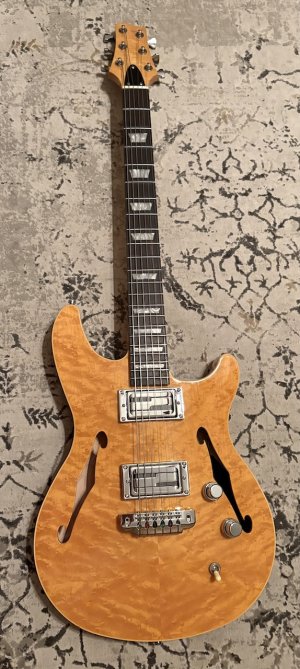

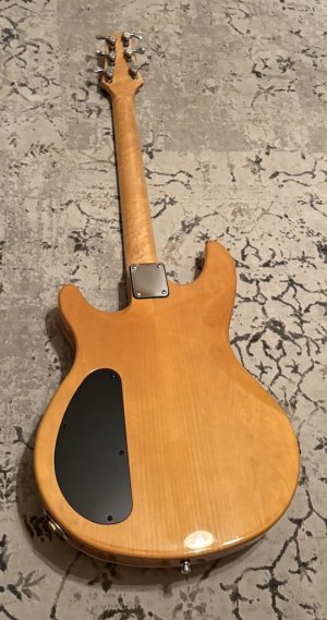

Here are a few photo's of my VIP called Precious.
Guitar Body: VIP Carved Top - Hollow
Lam Top Wood: Birdseye Maple
Core Wood: Maple
Paint/Finish: Transparent - Vintage Tint Gloss
2 F Holes
Neck: Warmoth Birdseye Maple/Ebony/59 Roundback w/Vintage Tint Gloss
Locking Tuners: Hipshots
Neck & Bridge pickups: Alumitone Fusion Jazz 251 Humbuckers
Switch: Freeway Switch wired using the HH Parallel Scheme 2V/2T wiring diagram from Freeways website.
2 250K Concentric Pots
.022 mfd cap
Gotoh Wraparound Bridge

Very nice. That's a nice birdseye top and matching neck. Very clean look.
