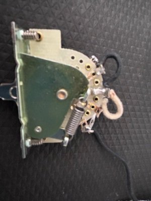

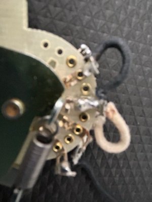

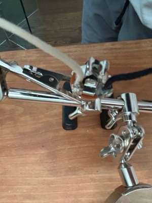

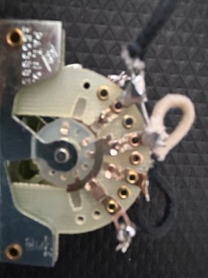

I build a control plate with a 3 way switch. It isn't elegant but seems to have continuity. I messed up there as online advice said to use Weller ETB tips with my Weller 1010NA soldering station. I had lots of trouble getting the solder to flow (60/40 solder) and as a result the connections look messy. But they seem to have continuity based on my multimeter.

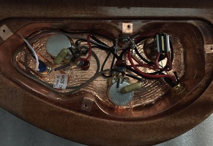

I connected everything, put strings on the guitar (probably should have only put one on to test, but ...) and plugged it in. I got sound for a second and then nothing.

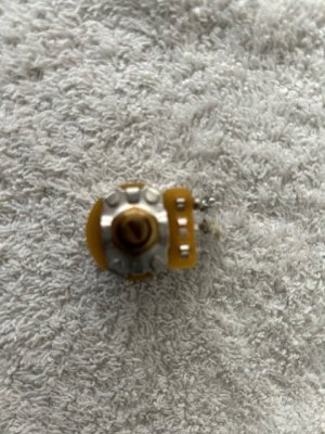

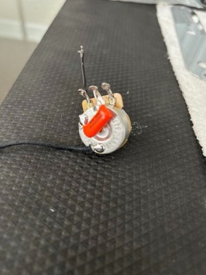

I disconned the control plate and re-tested the wiring. Everything test OK but the volume pot seems dead.
A couple of questions:
(1) Would my problems with solder not flowing, and as a result having to set the solder station tem higher (750F), be possibly due to the pointed tip rather than a chisel tip. I used the ETB tip but it looks like maybe the ETD chisel tip would have been better.
(2) If I fried the volume pot because I had to hold the tip at 750 F for longer than desired have caused the pot to pass sound for a second than go dead, could this be the only issue and mean I just need a new volume pot?
