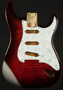

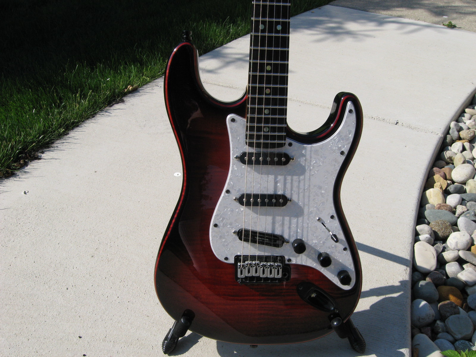

They do it. We just addressed this very recently, but I'll be damned if I can find the thread. I also can't find the pictures I used, which demonstrate the effect more clearly. My photo collection is huge, but largely disorganized. However, I did find these...
That's not a custom order; I bought that off The Showcase back in 2009.

Yeah I imagine if you want the "binding" a different color than anything else on the guitar... that's going to be a price hike because they have to mask it off differently. But finishing the whole thing in one color, masking, and then shooting a black burst (giving you binding the color of the body) wouldn't be any harder than masking first, finishing in one color, and then shooting the burst (giving you natural masked binding).
Yeah, thats what is shown in the photos above. I guess i took "unnatural" to mean something really out there.
