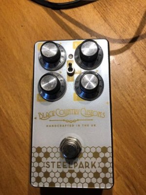

Next, get a compressor and a treble booster. I have an onboard JangleBox on my 360.
