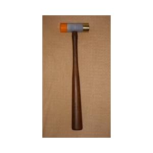

Yes, they're tight, and supposed to be. By hand, you'll probably have between 1/16" and 1/8" left to close up once you've pushed them in as far as they'll go. Don't try to open the holes up or you'll wreck 'em - there's a shelf in there. Just push the bodies in as far as you can and thread the top retainer bushings on until they're flush, then tighten them up with a 10mm socket. It'll pull the tuner in the rest of the way. Or, if you like to live dangerously, you could spank on the tuner bodies with a small fret hammer...

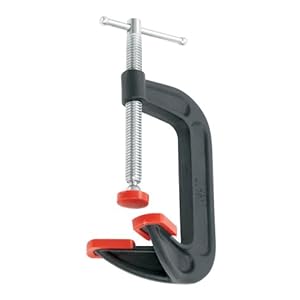

...or, try squeezing them in with a clamp...
Either way will work, but you will be applying pressure to the locking pin flange that it's not designed to take so there's some risk of breakage.
