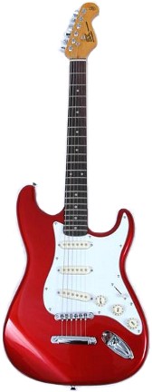

As far as I know you could use one on a strat but it would look ugly in my opinion. Maybe that's what they meant. Here's a reference picture:

It doesn't look that bad, I'd prefer a string through with the TOM, I like the bigsby look also,, In fact, anything that strays from the norm can be apealing, you guys stuck in a rut or what?

I like some weird combinations of parts but the TOM on a strat looks weird to me. I can deal with a Floyd on an LP though. :toothy12:

Yes, Tune-O-Matic bridge can work just fine on Strats, we just need to angle the neck pocket to allow the strings to lay over the fretboard properly.
Another option to consider is our new recessed Tune-O-Matic option which allows you to use this bridge, without having to angle the heel pocket.  Also this bridge option features three different patterns of string through holes to choose from, very cool.

The reason the picture looks weird is that you used a top route body; lose the pickguard and go rear route and the TOM bridge stops looking so weird...
I'm toying with doing a Strat or Tele "Special"; mahogany body & neck with rosewood fretboard and vintage P-90s/Giibson tyoe hardware to do the old LPS in a Fender form factor...

ah i see, ill get  a recessed one with back route, and since it has a 12 radius should the neck also be twelve or what? cause gibson necks arent but they use TOMs

I think it looks bad, but may be ok on a backrouted strat.
