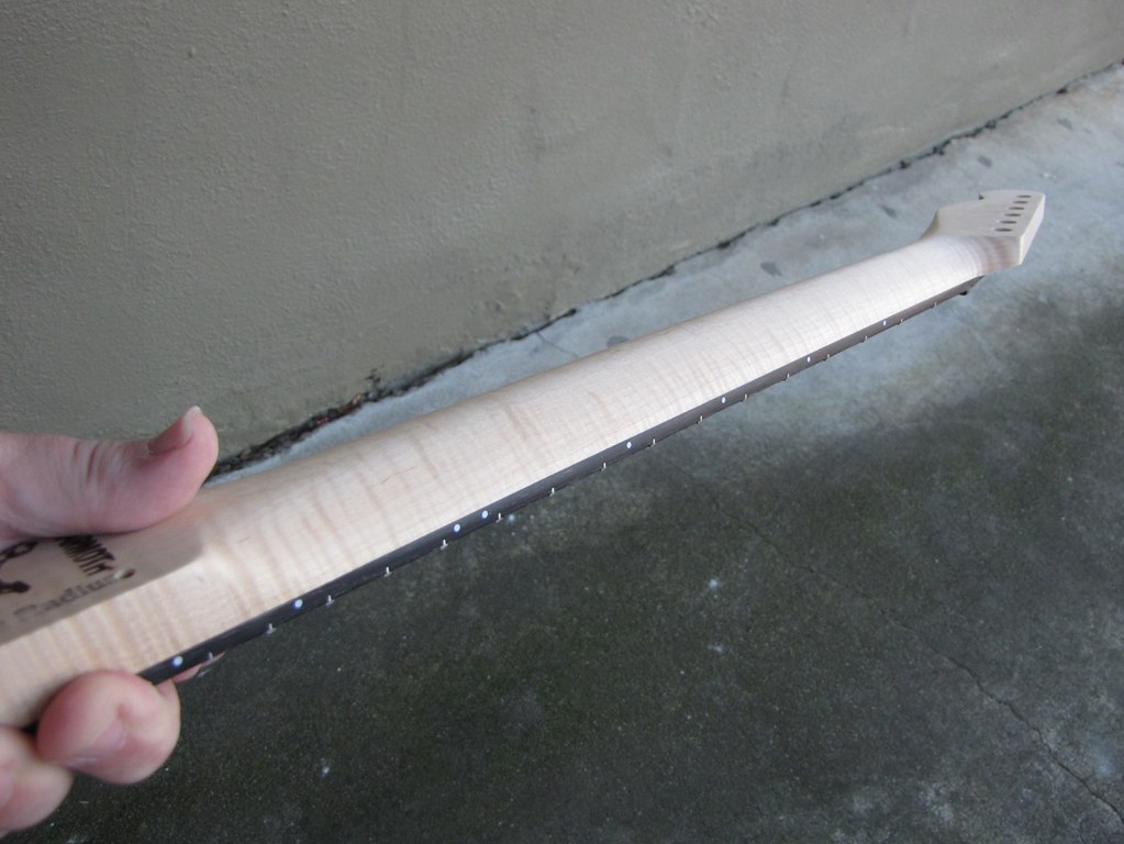

Tru-oil will give your piece a a very slight amber cast, and the more you put on the more pronounced the phenomenon becomes.
Before:
After:
It can darken over time.  After after:
I would say I applied more product than I needed to on this neck.  It was my first go and I didn't want to under-do it and so I over-did it.  It feels a tad stickier than I'd have preferred, but not unbearably so.  I think if you want to get a satin finish, you're probably best off going with very thin coats, and not very many of them, and using the synthetic steel wool to dull it down.
Bearing in mind the very  heavy application I used here, defects are that its stickiness will be offputting to some.  It will likely be more prone to damage than a poly finish (but that's true of everything besides poly).  It's easy to fix by sanding and re-applying.
Overall I like it, and I have one other finished neck with a much thinner application that I'm eager to put into service to compare.  I will continue to use Tru-oil on maple necks.

Damn, that's a nice piece of curly! Too bad about the headstock, though.
I agree, it's a handsome bit of lumber.  Blows my mind that it was in the showcase for $215 with that fretboard on it.  And it's a substantial beast, being a boatneck - I'm put in mind of Spinal Tap's road manager, Ian Faith, and his trusty cricket bat.
