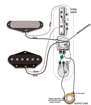

I figured giving 50s wiring a try, so got the attached wiring diagram and followed everything.
Now all seems to be working fine except the middle position on the 3-way selector switch: there is no sound at all, while I should get Neck and Bridge humbuckers combined.
Any idea what I need to change?

Your switch has nothing connected in terms of pickup signal when in the middle position.
The diagram also says gorunded rather than grounded.
Look for a Tele wiring diagram to see how the 3 way needs to be wired.

The wiring you have will not work with that type of switch.
The closest you can get is to wire the switch like a traditional Tele 3 way wiring diagram. Then take a wire from each terminal where the hot wire of the pickup attaches and connect it to the respective tone control.

Neither of these will work, the first one for the reason @stratamania said, the second because you’ve tied the two hot leads of the pickups together.
Do you absolutely need two tone pots AND 50s wiring? This would be very simple without 50s wiring, or if you re-used a tone pot for something like a spin a split or a passive bass cut so the tone control didn’t need to be switched.
Or, you can buy a three way super switch and I can show you how to achieve your desired 50s style V/T/T setup.

Yep, that’s just a modified Tele wiring with the tone control moved to the middle lug of the vol pot instead of the input lug as @stratamania suggested. Note that the pickups are wired to the commons - the red terminals in your diagrams.
