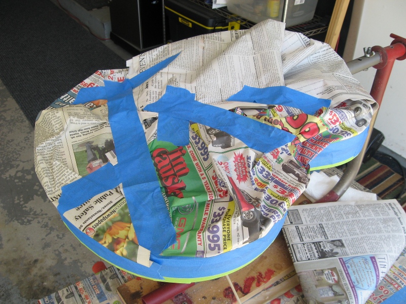

I'm builing a Wenge chambered guitar with a flame koa top. I want the Wenge part to stay raw but have a glossy finish on the koa top. Is it even possible to apply a finish on the top only?
Sure. Just mask it off. Kinda like this...
I had to mask over the top edge because I had binding on that body, but the idea is the same. Cover up what you don't want to get paint on. In the case of that body, I wanted to leave the sides and back natural, but put a solid color on the top.

It's a bit late now without refinishing it, but you really need to seriously degrease the wood, especially the Rosewood. Naptha works. Lots of it. Then, don't mask off the sides of the fretboard, just the top. Shoot a coat of sanding sealer on that, then sand it back a bit with some 320-400. Clean it again, then shoot whatever finish you want over that and do whatever follow-up you want to get the surface you want.
If you want to start over, get some paint remover with Methylene Chloride in it. It's about the only thing that'll cut poly.

Are you talking about the L5S body above? If so, it is as Altar says - I had to plug a lot of holes, and there's no way that would look right unless it was covered. I left the sides and back natural because you're right - it's a beautiful piece of Mahogany. Broke my heart to cover the top. But, I don't like having the controls too far away from my hand and I don't like having so many controls. I'm also not a huge fan of the TOM/STP termination.
I wasn't the original owner of that body; I got it in a trade for an Ebony over Wenge neck. If I'd have ordered it originally from Warmoth, I wouldn't have had it drilled out the way it was and the top would have remained natural.
