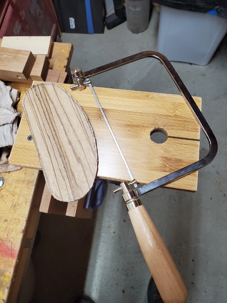

This page-https://www.lmii.com/blog/2017/10/07/55/ gives some decent tips. Abalone can be hard to work with depending on the raw material shape. You can buy sheets of it now a days which makes it a little easier. A jewelers saw is needed as well as a saw bench, which looks roughly like this:
and small files that are sturdy enough to handle the abalone. (Note, that isn't a jewelers saw, it's just a coping saw. A jewelers saw blade looks more like a piece of wire.)
