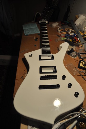

first build. this should be interesting. already concerned about drilling screw holes for all the plates, tuners, mounting rings. any tips? thinking of putting two duncan phat cats in her.
metalman22105 said:Tips on drilling:
Make sure you soap all of your screws (keeps the wood from cracking and keeps them snug)
I used paraffin instead of soap, but yes, this makes the screws go in much easier and avoids having one twist and break.
when you drill the holes for the pickup rings, make sure that you put the neck on FIRST, and string up the 1st and 6th strings as guidelines for the pickups (to help line up the pickup rings) someone told me this a long time ago and it has helped with all my builds!
Another good tip. I did not do this with my first build and spent endless time trying to site up the rings. This method helps greatly!!!
+1metalman22105 said:Tips on drilling:
Definitely measure twice or three times, and only drill once like Blackdog said!

dixonrich74 said:i'll check out a dremel. i'm a musician, not a luthier, so excuse my dumb questions, but is it helpful to drill slightly shallower than the depth of the screw so that the screw itself does the work on the last few turns?
dixonrich74 said:attached the neck. in the midst of painting the cavities with shielding paint. next is the drilling of holes. considering fralin p92s, HD z90s, or a vintage wound HB. any thoughts?![]()
