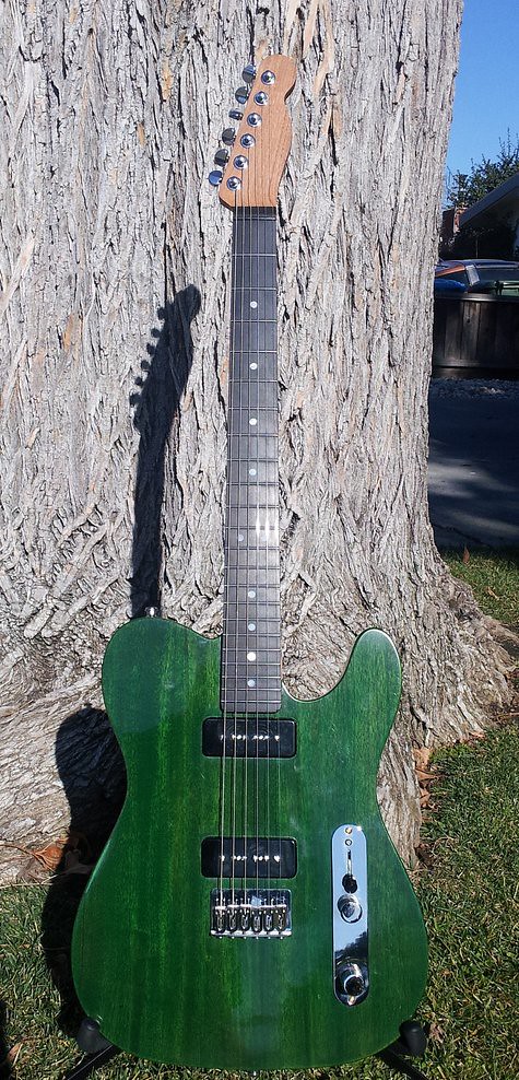

I first fell in love with the P90 when I got my hands on an Aerodyne Telecaster about 12 years ago.  They were a contoured basswood-bodied, rear-routed, single-bound guitar with a standard Tele bridge pickup and Fender's Black Dove soapbar at the neck.  I had never owned a Tele up until I got the Aerodyne because I really had no use for the conventional Tele neck pickup, but when I laid my hands on this model, it was all over.  Since then I've owned a Gibson LP Jr. Faded double-cut with two P90's, and that only reinforced my love of the soapbar pups.  The guitar itself was not my cup of tea, however. The shorter scale and the two-volume/two-tone scheme never felt right.  The Aerodyne and the Gibby have since been rotated out of the lineup, but my main electrics are two half-Warmoths, including my green 'Hog, loaded with Roadhouse True Blue P90's (no longer being made):
