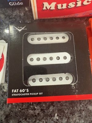

Currently the build list is as follows:
Electronics:
Fender CS Fat60’s pickups
Master Volume
TBX Tone Stack
Blender (currently Armstrong mod

Next I’ll be saving up for the pickups.
