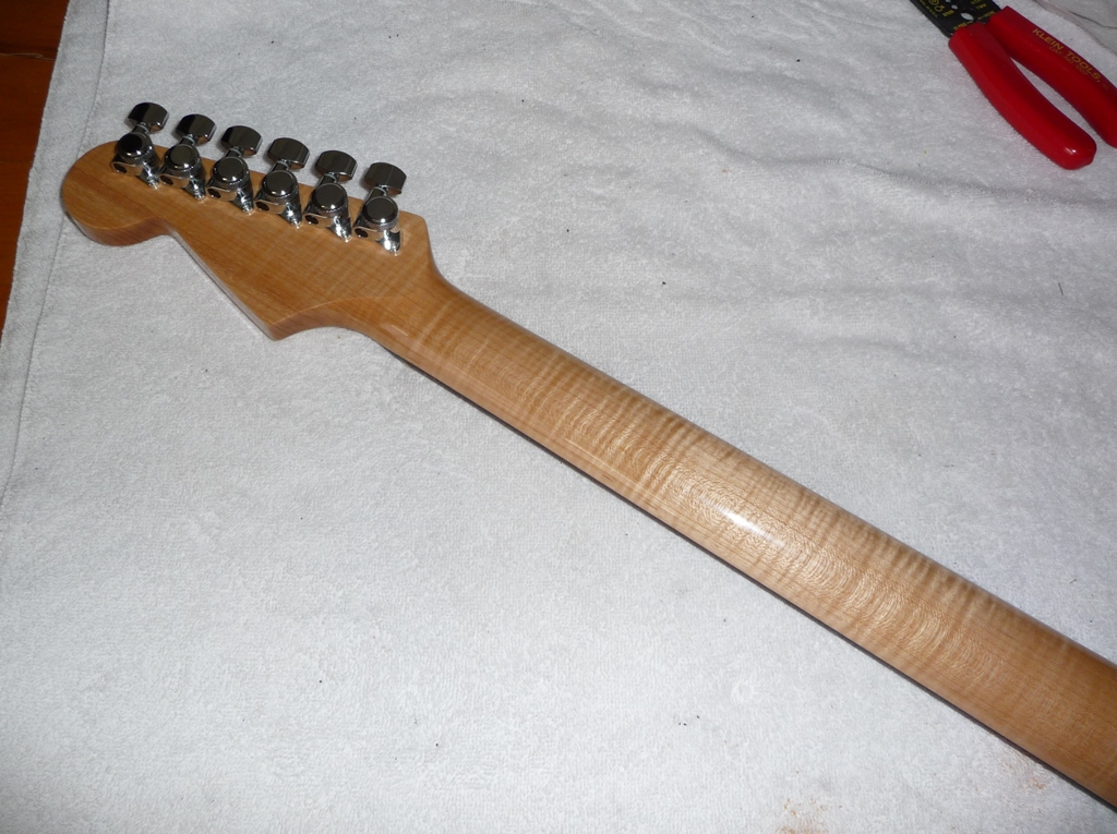

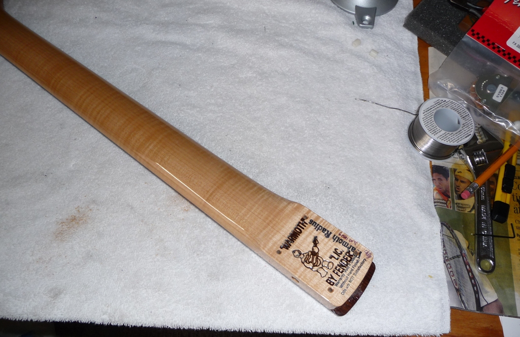

Neck is ready to go, quartersawn flame maple with rosewood fingerboard:
I am patiently waiting for the arrival of the UPS man tomorrow with my body:

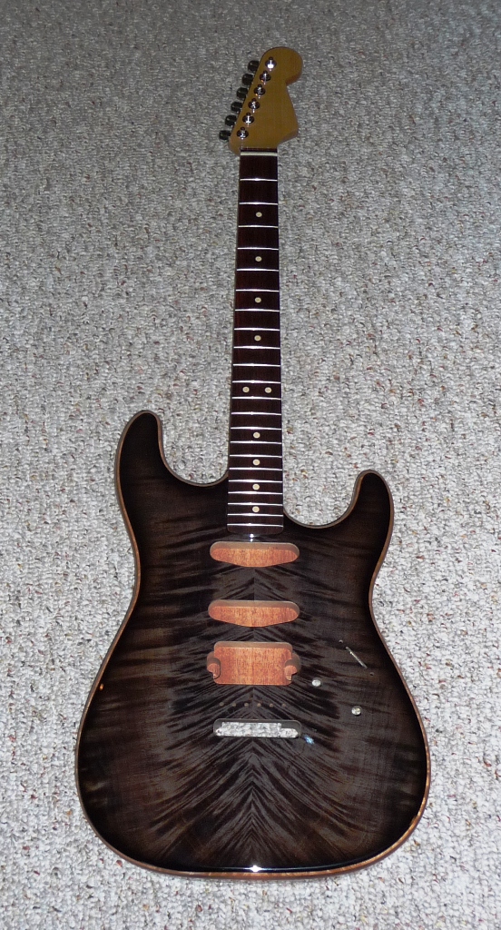

Thanks! I was not planning another build so soon but I already had the neck. I had decided I wanted to give Mahogany a try for the body and was thinking about trying a DIY finish again. Then this one popped up in the showcase I HAD to grab it.  I'm pretty excited, I think I will get it built fast...
Note to self: stop watching the showcase all the time!  :laughing7:
showcase drives my imagination!  i saw the raven there!  only reason i went blue was id like to have it black dye back too..  the raven is a great name for that feathery finish, you gotta get a custom neckplate!  maybe all black with an outline raven head in profile? spooky like.  with a red eye!
I already bought a plain neck plate for it but I agree, it might be time for my first custom plate. Something about that top really does look like the wings of a black bird. Is it Friday yet?
