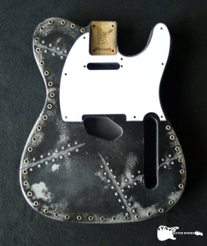

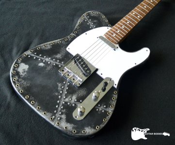

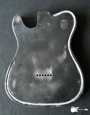

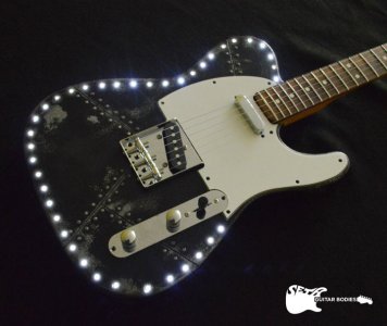

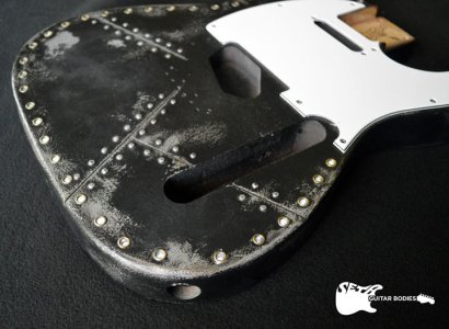

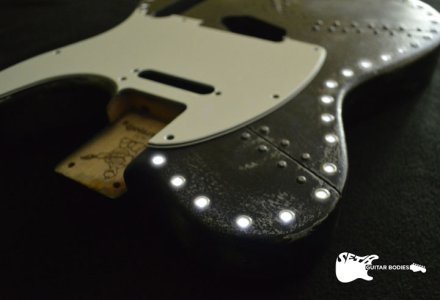

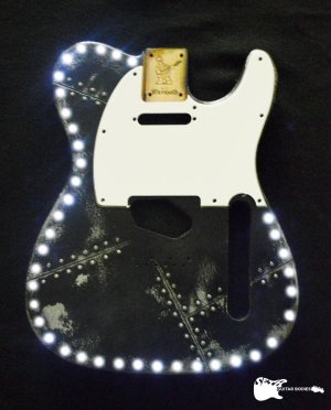

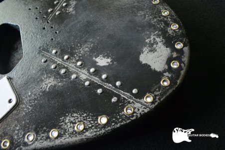

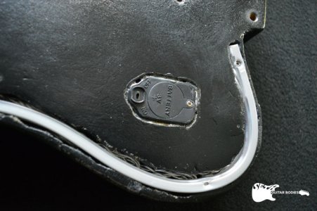

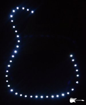

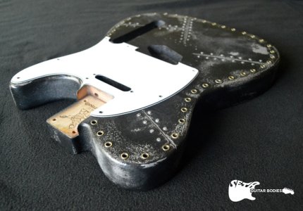

A Tele with 39 LED lights. This is a prototype, so the back is a little rough. It has a routing similar to a B-bender for the lights to be installed from the back. I filled the route with an artists flexible ruler. Not pretty, but hey...it's the back of the guitar.
I modified the LED lights with a coin-type battery holder (as opposed to the triple AA battery holder it came with) for a nice flush-mount on/off switch on the guitar. These lights lasted five days (continuously on) on a single battery.
Anyway, I think there could some possibilities with this. Starting the next one soon.
