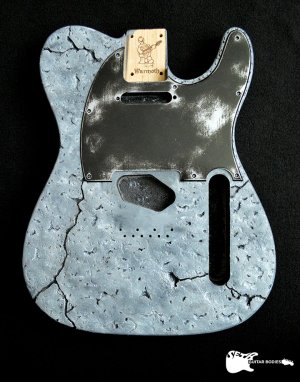

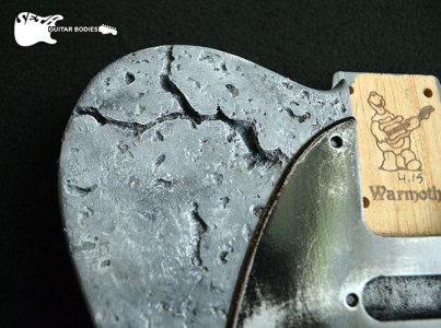

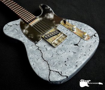

Carved from a Warmoth alder body, this Tele is made to look like a slab of cement with stress fractures and pitting.

That's outstanding. I didn't blow up the pics to look, but did you break the body apart and glue it back together?

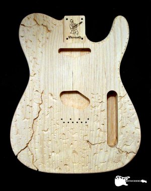

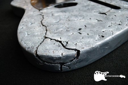

Thanks. No, the body is all one piece. I carved the cracks right into the wood. They are only about 1/4" deep, so the strength of the body isn't compromised at all. I painted the insides of the cracks black to make them look a lot deeper. It's a little Disney magic!

Did you use a paint which mimics the look of cement, or did you add a thin veneer of cement down? It's that hard to tell!  :laughing8:

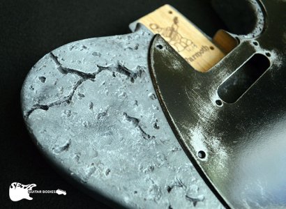

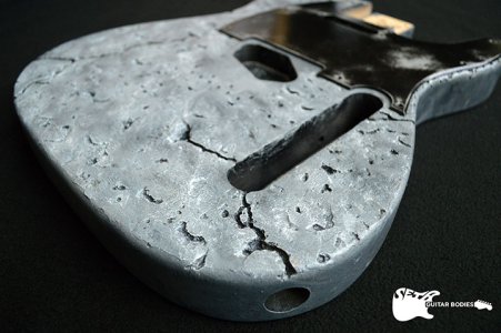

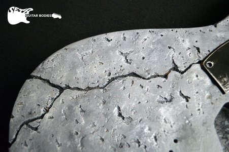

Thanks! No, it's just paint directly on the wood. If you look at the pic of the unfinished body, you'll see that every little hole and crack was carved. The key is to "model" the finish so it's not completely solid. I studied real concrete, and when a tiny piece breaks away, the exposed edge is much lighter in color because it's not been exposed to the elements and dirt. So I used a dry brush technique to highlight all of the tiny edges with almost pure white. Several coats of lacquer helped smooth over the wood effect. It was fun figuring this one out!
