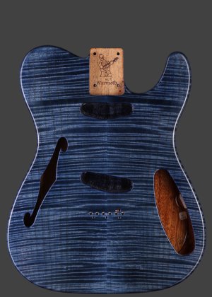

You don't need to wood-mount the Strat bridge pickup.
Individual metal Strat pickup mounts are available, I have one for the bridge pickup on my Tele-thinline which was routed for a Strat bridge pickup and hardtail bridge.
A picture of the body should be attached to this posting.
