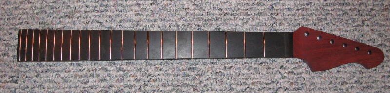

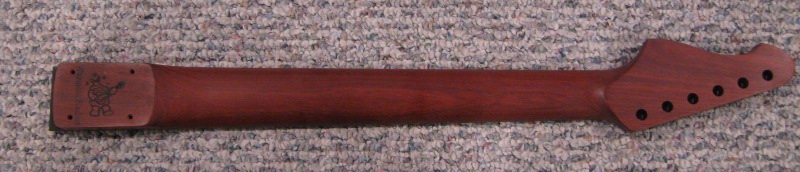

Telecaster body is done, but now I need your opinion on what neck!
Here's what I'm talking about, although it's a Warhead vs. Tele headstock.
That's before I leveled/crowned/dressed/polished the gold frets or burnished the neck meat, so it's looking a little raw there.
I just priced up a new one in Tele dress at $312 (no frets, no nut).
Ebony over Bloodwood is what I got on one of my builds.
Unfortunately for me, the chambered body is a tad too light compared to the slightly heavier neck giving me slight neck dive issues.
Aah, but the tone ..! And the feel of it ..!
It's very sweet. A fantastic wood combination that feels/sounds sublime. The only downsides to it, if you can call them that, are its color and density. The color is beautiful - I don't mean to take anything away from it - but it's not going to just automatically match up with any ol' body finish. For example, it would look quite out of place against a seafoam green body. Then, the density is also good inasmuch as it'll make the guitar ring and sustain very well, but that also makes it heavy. The stuff is like red Ebony, if there were such a thing. The weight could exacerbate the neck dive tendencies of some body styles/constructions where the forward strap hanger is too close to the center of gravity or the construction is too light due to wood species/chambering. For example, it's unlikely it would be comfortable to play on a Diamondback, Nomad or Iceman body. But, on any of the traditional body styles, it works well. A typical run-of-the-mill Rosewood over Maple neck weighs about a pound with tuners on it. This one will weigh two. So, you're adding about a pound to the weight of traditional Tele. Doesn't sound like much in the grand scheme of things, but a typical Les Paul weighs about 2 pounds more than a typical Strat, and as many will tell you, that difference feels like 10 pounds after about an hour of it hanging around your neck.  All that said... it would look/feel/play/sound fantastic on that Tele body of yours.
