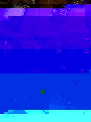

Theres another discussion on this somewhere else. To be honest mate, I think it would be a really bad idea to even think about NOT filling swamp ash. Remember that Grain filling really doesn't alter the colour that much unless you go really dark. Even then its a really similar colour to what it originally was.  If you use a light brown coloured grain fill you will get the classic "natural" colour.
Not grain filling will, in my opinion just make the woods surface feel uneven and kind of "bumpy". Check out the pick of this one someone on another forum did, its just a tung oil finish straight on swamp ash. Look at the light, the uneven feel of it. That guitar would look and probably feel a hell of a lot better had the guy filled it in my opinion. Properly filled swamp ash, is in my opinion THE best wood for a natural finish, its just gorgeous.
Filling swamp ash is hard work (you'll need 3 fills and thats a lot of sanding). Is it worth that? A million times yes.
