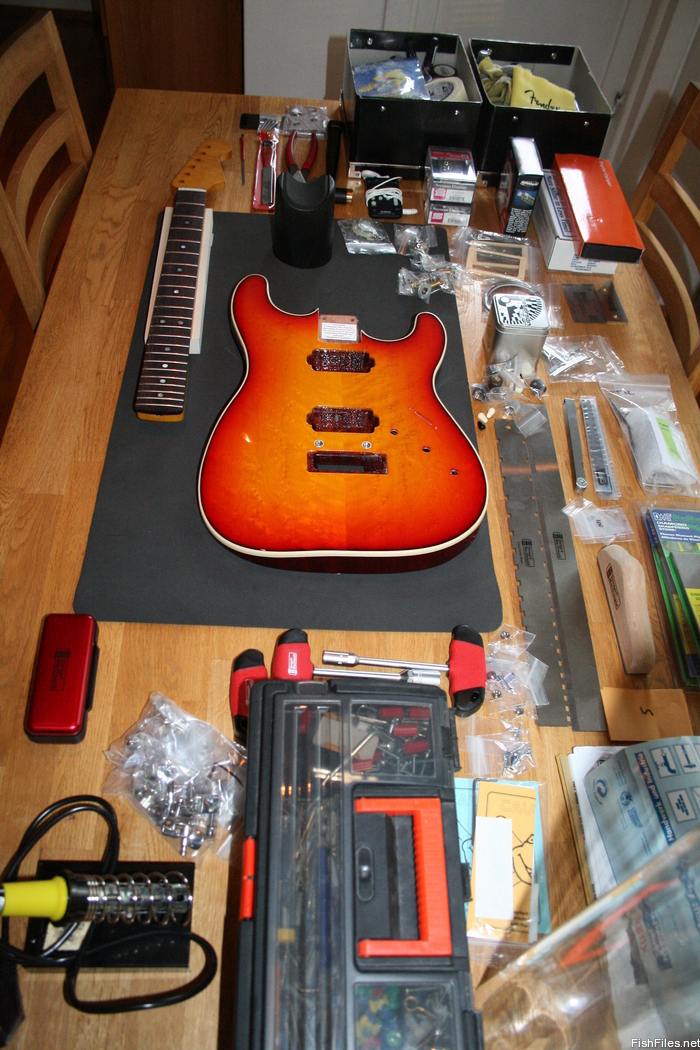

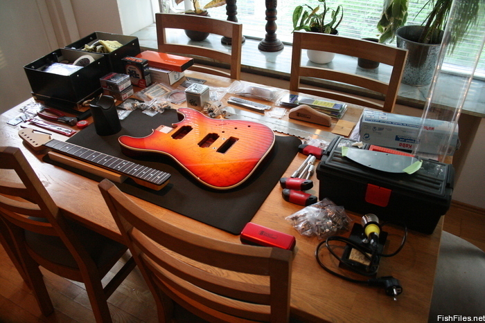

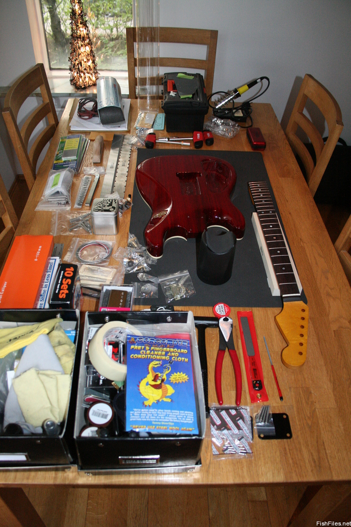

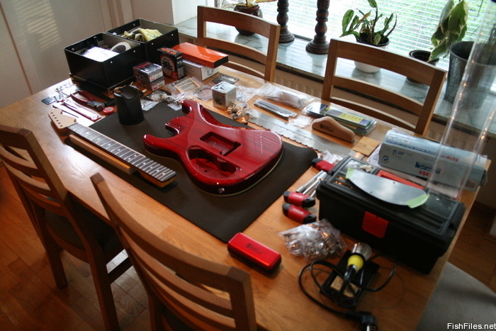

This is a LP/SG flavoured Stratocaster. I have set everything up for the project and I´ll begin working on it tomorrow. I hope it will be finished in a week or two. :)
More details in unboxing thread: http://www.unofficialwarmoth.com/index.php?topic=17318.0

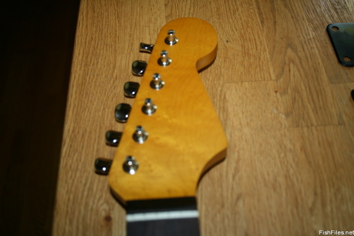

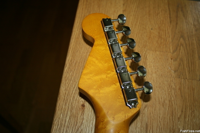

Hi

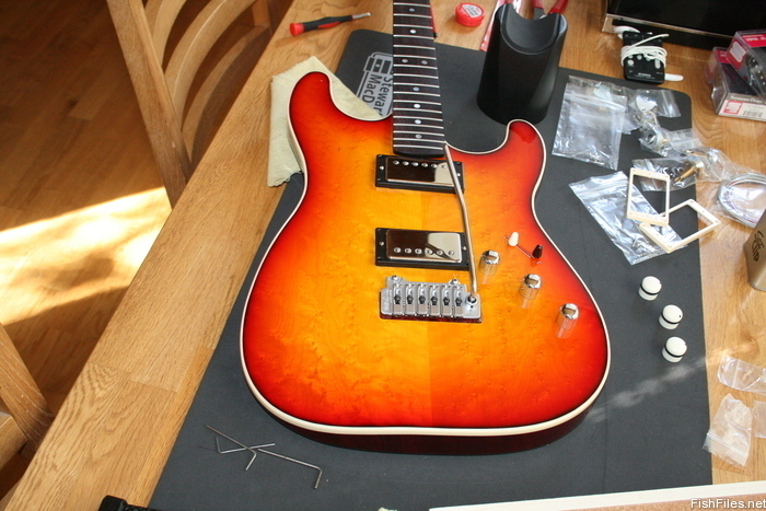

I just installed the tuners this morning. I have done this few times before, so no problems there. Later today I will install the Wilkinson bridge, string up and see what it does.
Hi again!

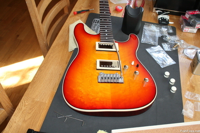

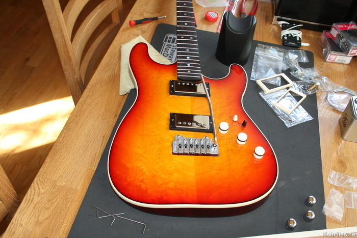

Here are 3 options I am thinkin of, what do you think? I know I can change it later, but nice to hear your views? :)
Option 1: Black rings, chrome knobs and black or mabye cream tip:
Option 2: Cream rings, chrome buttons and cream or black tip:
Option 3: Black rings, ivory buttons and black tip.
PS: I´m not sure if I like the recess for the tremolo, I should have picked regular rout, I think there is too much gap.  :icon_scratch:
For god's sake go all black / chrome! Are you kidding? OR go all cream, sheesh. Never mix and match black and white plastics on a guitar. The metal needs to be one color, the plastic bits one color.
BTW that thing looks really truly awesome.
That body wants my Ivory EMG 58's. That would be sexy with the ivory knobs and tip and no pickup rings.      I'll make you a good deal. :headbang1:
You guys keep it up and it'll turn into a one-eyed, one-horned, pigeon-toed, over-growed flyin' purple people eater <grin>
Hi
Thanks for the comments. I went with creame rings and tip and chrome knobs....it looks great. :)
I have been working on the guitar since early this morning, with few short breaks, and I will finish it tomorrow. I have the wiring left (already installed the pots, swich and knobs), and file the not slots to right height.
I have done a rough setup on it and it plays great, the 59 profile is fine, but I still prefer standard thin.
Accoustically it is also great, but a little different than my other guitars, but the sound is very light and rings out more......mabye the cambering or the Wilkinson bridge......what ever it is I like it. :)
I have a feeling this will be my number one guitar, at least for a while. Eyyyyyy  :icon_thumright:
