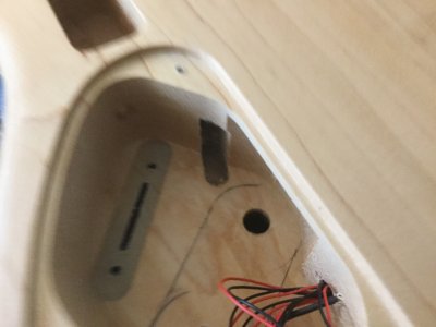

Any good tips on feeding the neck and middle pickup wires down the channel to the control cavity on a rear route strat?

Tie on some fishing line with weights on and let gravity and a little shake do the work.
(In practice I found just keeping on trying to poke it through worked, eventually.)
Hm, good idea!
oh, I don't have fishing gear.
well it is a line I can see if I can improvise.
Thanks
possibly a used old high e string?
I've never had a problem just pushing the wire so I don't have any tricks.
Ok, so once I looked closer at the relationship of the slot to the pickup hole, I realized that it is just about 1/8" in.  By making the pickup wires as straight as possible and then angling them into the hole, they slipped straight down.
We are good to go!

I cut some zip ties, put in a hole with hot needle, tie on some dental floss, tie the other end to the wire, pull it thru with the zip.

Bicycle valve or surgical tube is a useful method.
