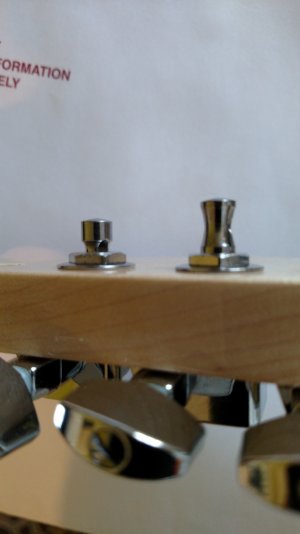

I'm replacing the neck of my 2009 Am.Std Strat and I was planning to utilize the original tuners.
After installing the D tuner, I realized that it was not high enough for the string to be properly wrapped through.
Do you have any suggestions on how to get around the problem other than possibly buy new tuners?
Thanks in advance for your time.

Make sure the nut is tightened fully and also check if you could use a somewhat thinner washer.

Nut is tightened and I'll definitely check for a thinner washer (homedepot?).
But I'm surprised at the fact that the Warmoth headstock is thicker. Unless my specific neck is somewhat defective, how is it that no one has ever encountered this problem?
The hole in Fender’s tuning post looks to be very close to the nut. A minute difference in headstock thickness could make this difference you’re experiencing.
That's exactly my point. How is it that Warmoth does not mentions that their headstocks are thicker than standard strats and how is it that no one else seems to have posted about this problem?
Even if I want to get new tuners, what measurements am I supposed to take in order to find some that are taller than the current ones I own (Schaller) ?
Maybe measure it accurately and check with Warmoth that yours is to spec? If you don't have a digital caliper, get one, they're cheap and very useful.
A quick Google suggests that Fenders can vary between ~0.5" & ~0.6" - the only Warmoth I've had occasion to measure was 0.57".
I just measured 4 Warmoth Strat neck headstocks here, and they were all .55" to .56", with the thicker one having a finish on it. So, it's unlikely a headstock problem.
I also measured the thickness of three Warmoth headstocks. They were pretty consistent at .565", .573" and .575". None had a finish on them. They were purchased within the last two years, the first two fairly recently.

I just measured the W neck and it is 14mm. My Fender neck is 12.7mm. (Pls forgive the mm measurement)
I did put the tuners back on the Fender neck and they are just fine so at this point the question is:
Does anyone know what tuners will fit for sure on a W neck with 14mm thickness?
Thanks again.
I've never encountered a set of tuners that wouldn't fit on a Warmoth, and I install a lotta tuners.
You may want to check to be sure the tuner body is sitting flush to the rear of the headstock. Warmoth drills those hole pretty exactly, and some tuners don't slide in all the way. You have to pull them up with the threaded bushing used to secure the tuner. Also, are you sure the tuner peg is too low? The high E peg's string hole is sometimes pretty close to the face, in the interest of getting that last useless fraction of a degree of angle on the string.

For reference, .56" is 14.2mm so yours at 14mm is to be expected. I have an '03 Squier Strat neck lying around that measures .575" or 14.6mm.

Maybe these fender tuners were designed only for this neck.  Fender violates their own standard specs on a regular basis.  I've had problems with trying to reuse Fender pickguards.  The Warmoths will always work on the Fenders, but not always visa versa.
If you want to replace the tuners, you've got a ton of choices, but I'd look at hipshot, planet waves and gotoh's.  I've used all three with success.
Well, I ended up buying a set of Grover Rotomatics 305 series and they fit just fine. Since they are not staggered, I'll have to install a string tuner. So I installed strings and I'm letting the neck settle for a while and then I'll see what needs to be worked on (Nut , truss rod etc.).
