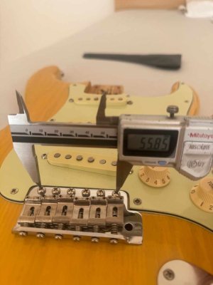

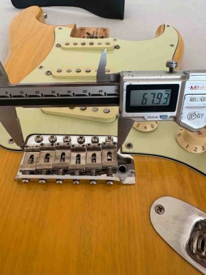

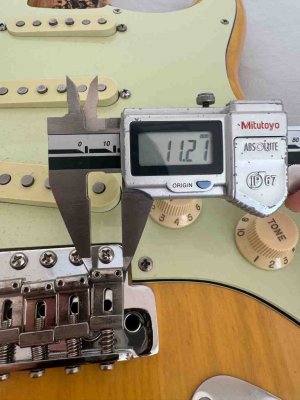

Your photos didn't show. If I had to guess, it's the forum's limitation on size. I usually resize my phone photos to 40% before adding to a post here.
Edit: Never mind. Let me check those measurements ... 😉
Upvote 0
67.93 - 11.21 = 56.72.
56.72 / 25.4 = 2.2331
"Vintage" spacing is typically 2-7/32" - 2.2188
I'd call it "Vintage" spacing. You should be able to find a bridge with 2-1/16" saddle spacing. To me, that would make more of a difference than a narrower nut.
Upvote 0
You’re measuring the wrong things. You need to measure low E saddle to high e saddle. That’s bridge spacing.
Next measure middle high e to middle B slots. Repeat ad nauseum
Now measure the distance between the centers of your outer mounting screws.
This all matters. The 1st item determines if this may be root issue (vintage 2 7/32 is wide) Next determines what saddles will work.
Following that is what bridges meet that criteria.
If I had to guess : you have 2 7/32 on both mounting and bridge. Callaham has a bridge that mounts a smaller bridge to the larger mounting spacing, while using the smaller saddle spacings.
