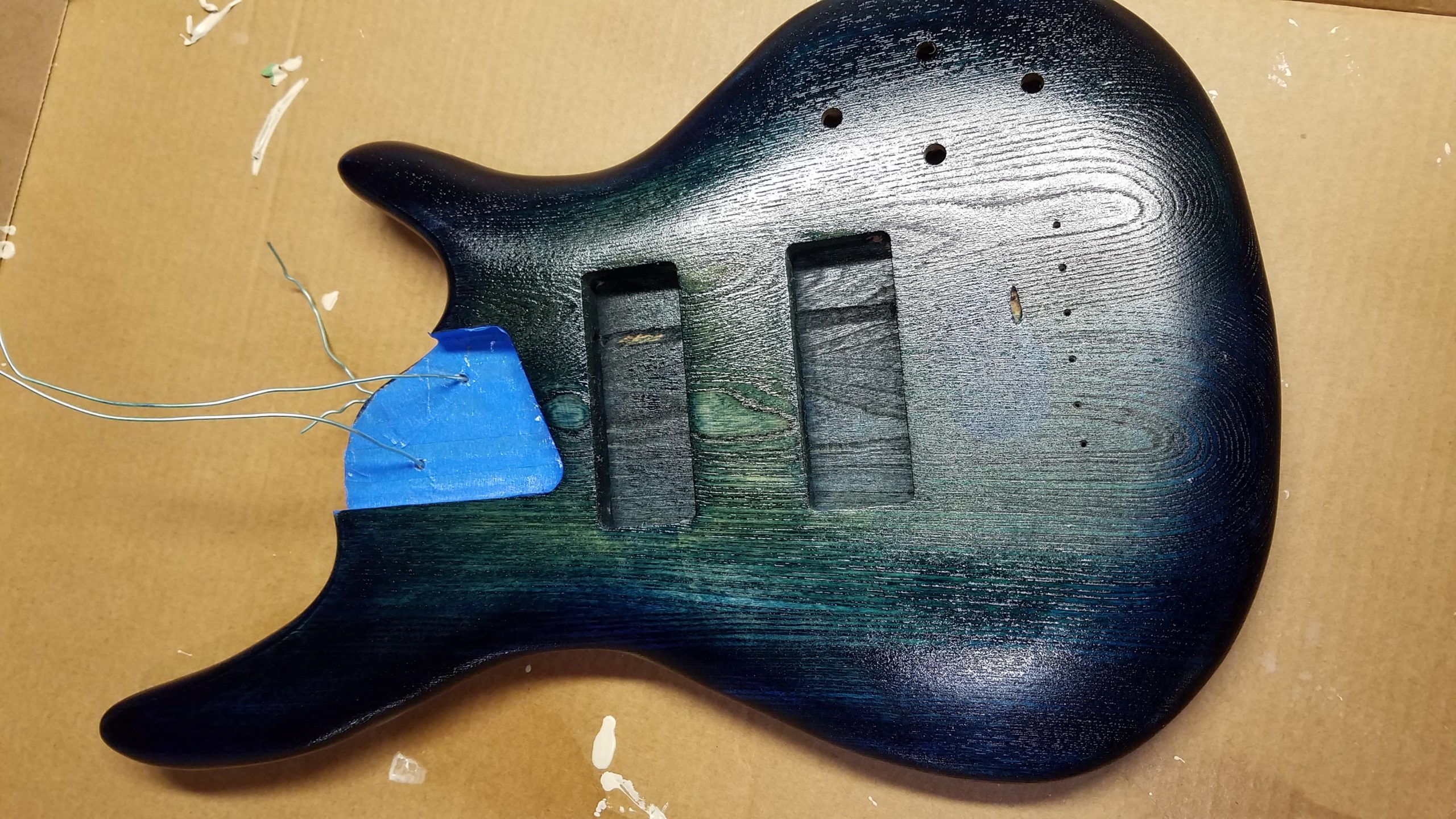

Adding a current phase photo...I'll be drilling new holes for tremolo posts tomorrow, so until this is finished I won't be putting anything on.
